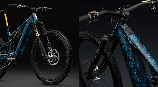

S-Works Turbo Levo SL
CUADRO All  new Levo SL SW Frame, Fact 11m carbon, carbon shock extension, 150mm  travel, adjustable head angle, BB height, and compatible with 27.5 or  29″ wheels.
AMORTIGUADOR S2-S6: Fox Float X Factory series, Kashima, 21x55mm, S1: Fox Float DPS Factory, Kashima, 210x50mm
HORQUILLA Fox 36 Factory. 29″, 44mm offset, Grip 2 damper, Kashima, 160mm
POTENCIA Deity, 35.0mm
MANILLAR Roval Traverse SL Carbon, riser bar, 6-degree upsweep, 8-degree backsweep, 30mm rise, 780mm, 35.0mm
PUÑOS Deity, Knuckleduster, Black
FRENO DELANTEROSRAM Code Silver Stealth, 4-piston caliper, hydraulic disc, 200mm
FRENO TRASERO SRAM Code Silver Stealth, 4-piston caliper, hydraulic disc, 200mm
MANDOS DE CAMBIO SRAM AXS POD Controller
CAMBIO SRAM XX Eagle Transmission Derailleur
CASETE SRAM XX Eagle Transmission Cassette, 12spd, 10-52t
PEDALIER SRAM Carbon Crankset, Dub interface
CADENA SRAM XX Eagle Transmission Flattop Chain
PLATOS New SL 1.2 spider, 104BCD w/SRAM 32t Transmission compatible alloy ring
LLANTAS Roval Traverse SL Carbon, 29 Front, 27.5 Rear, 30mm inner width, hand-built, 2Bliss Ready
BUJE DELANTERO Roval Traverse SL, sealed cartridge bearings, 15mm thru-axle, 110mm spacing
BUJE TRASERO Roval Traverse SL, DT Swiss Star Ratchet, 54t engagement, SRAM XD driver body. 12mm thru-axle, 148mm spacing
NEUMÁTICO DEL. Butcher, GRID TRAIL casing, GRIPTON T9 compound, 2Bliss Ready, 29×2.3″
RADIOS DT Swiss Competition Race
NEUMÁTICO TRASERO Eliminator, GRID TRAIL casing, GRIPTON T7 compound, 2Bliss Ready, 27.5×2.3″
CÁMARAS Standard, Presta Valve
SILLÍN Bridge, 155/143mm, Hollow Ti-rails
TIJA DE SILLÍN RockShox Reverb AXS, 30.9. 1X remote, (S1:100mm, S2: 125mm, S3: 150mm, S4-S6:170mm)
ABRAZ. SILLÍN Alloy, 38.6mm
MOTOR New Specialized 1.2 SL Custom Rx Trail Tuned Motor
UI/REMOTE Specialized  MasterMind TCU, percentage of remaining charge, 120 possible display  configurations, Micro Tune assist adjustment, over-the-air updates,  ANT+/Bluetooth®, w/Handlebar remote
BATERÍA Specialized SL1-320, fully integrated, 320Wh
CARGADOR Custom charger, 48V System w/ SL system charger plug
CABLEADO Custom Specialized wiring harness
SWAT SWAT CC steerer tube integrated tool with chain tool and link
PRECIO 14.000€
